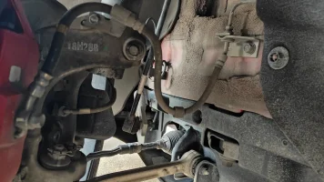

So I took a chance and ordered the Concept 3 Performance brake hoses as they looked like a quality piece, and in the pictures looked a bit closer to the correct size. The size does indeed seem closer to OEM Stinger hoses at 21.5" front and 13.5" rear (measured full length - including hose and fittings).
Unfortunately they did not come with any clamp/bracketry for the front lines to attach to the steering knuckle , even though their description says "Brackets and Fasteners Included". I emailed them about it and will post here after I get a response from them.

After seeing @Hawk853 's post about the hosetechnik braided lines I just ended up ordering a set of those, and I'm glad I did. They look great, are the right length and come with the bracket and grommet to hold them onto the steering knuckle just like the OEM ones.
Also I talked to Ryan at Forge Motorsports/hosetechnik and he added the U.S. as a shipping option on the website, so I was able to order them online and didn't have to go through any hassle with custom shipping quotes. Delivery from the U.K. to U.S. east coast only took 4 days.

I actually ended up installing the Concept 3 lines. Whatever hosetechnik sent me was not for a Stinger, the fittings were completely wrong. I'm very happy with them and they are probably the closest ones out there to matching the length and fitting style of the OEMs.

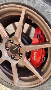

On the 2.0T, I bought Carquest Platinum vented solid rotors from Advance Auto. Unless you want the racy looks of drilled and/or slotted, plain old solid vented rotors have better structural uniformity, less stress risers, and produce more uniform temperature gradient in in high brake load usage.
Brake pads are the far more important piece in the brake puzzle and, as such, require much more deliberation on what might work best for the most severe type of driving the car is likely to experience. I knew mine was going to see full-on track day events, so I went with EBC Bluestuff. You will have to decide for yourself what might work best for your application.
The combination work quite well for me. This is after the last of four 20-min sessions at MSR Cresson back in 2022. The rainbow hues on the rotor was micro deposits of brake pad material, which occurs as part of the bedding in procedure with the Bluestuff. This allows the brake pads to ride against itself, instead of the rotor's raw cast iron. this produces the best braking force and wear characteristics for track running.
