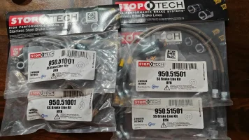

I bought the Stoptech meant for the Genesis Coupe. Haven't had a chance to install them but don't see why they wouldn't work. I'll post up pics when I get a chance to compare with stock lines.
Stoptech
950.51001 Front
950.51501 Rear
EDIT: Fixed

I think you have front/rear numbers reversed. 51001 is front, 51501 is rear, according to
Search By Vehicle Type | Brake Kit | Centric Parts (and repeat for 51501)
Yes I do, oops.

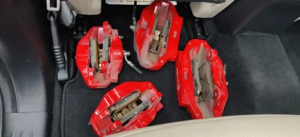

Yep. Very first mod I did when I got the Stinger. Back around the end of 2020, I search online to see if anybody had done a Brembo conversion. A few Genesis Coupes showed up, but no Stinger or G70. I looked on OEM parts microfiche site and confirmed the hub carriers, to which the brake calipers are bolted, are the same part numbers for 3.3T and 2.0T Stingers. So I was pretty sure the calipers would bolt right on. Wasn't sure if the Brembo calipers would clear everything else. Luckily for me, an ebay listing for a set of near mint Brembos calipers right about that time turned out to be a local seller, so I ended up meeting him in person and handed him 4 Franklins in exchange for the calipers. It was a leap of faith, but worked out great!
This is right after I did the conversion. Still on OEM 18s and stock everything else back then.

Silly question: are you upgrading both cars (Stinger + G70)? IIRC, you only need one "bag" for the front, one for the rear, but your picture shows 2 of each?
Do it, it's definitely worth it! Fronts have been done for about 6months now, rears getting done at the end of the month, when my snows come off. The 2.5T brakes are pretty good, but even with just the fronts done, it's GREAT!

Yes. Both cars have gotten mostly identical mods so far.
Highly recommend Brembo conversion. It is a must do IMO. If I can have only one mod done, I would value it above the JB4, or any of the suspension mods I've got. Granted, the enhanced braking is felt much more at the track, but even for every day driving, pedal response is much more linear and easier to modulate. I would even consider it a major appearance upgrade.
Granted, Brembo calipers have gotten a bit pricier these days. Now that everybody knows it can be done fairly easily, the demand has gone up. Most used sets I've seen are around $1k, so by the time you add rotors (and the rear dust shields, if you want to) plus other sundry items, it's $1500+. Even at the price, IMO it is still a performance bargain.
You can always do just the front and get 70-80% of the overall performance.

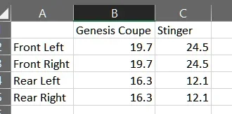

What had me worried is if you look up stock rubber brake hoses for the Stinger and Genesis Coupe you'll find they're different lengths. Here's lengths I pulled from Rock Auto:
I'm sure they use the same hose ends, but having brake hoses that are too short seems no bueno to me. Even the one photo on the khartunerz listing shows the braided steel front line visibly shorter than the OEM:
