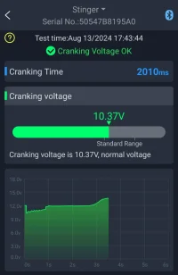

I recently purchased a BM6 Bluetooth battery monitor that "CLAIMS" to draw less than 1.5mA (which is insanely low)
Before installing it, I felt compelled to test it and sure enough:
  • Actively connected to Bluetooth = <2mA
  • Disconnected but searching for Bluetooth = <1mA
I was pleasantly surprised at such a low current draw.
It logs a data point every ~2mins, and stores 35 days of data. (Nifty)
Can even export the data to excel to satisfy your inner geek!

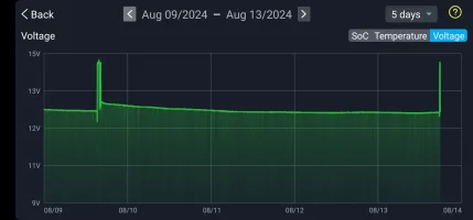

My resting voltage over 5 days (4 days rest) was 12.46.

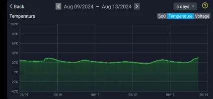

Temperature at the battery (car outside, on my driveway)
Even automatically tracks minimum voltage during starts, with a graph.

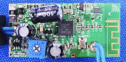

My point, never know what can happen with some of these after market parts. Coming from ALI, there's no UL testing. I just see a fcc certification because it uses BT.
They couldn't even align the pot to the circuit board. Given this device installs across the battery, I hope it doesn't catch fire one day ;).

Pic from the internet of the BM6
Final design does look better. My pic was from the fcc page.

I guess it would need to be inline with the car's cabling (or use an induction loop) to measure current draw, unless it can back into it from the rate of voltage drop.
Have you been able to observe a different rate of drawdown with the car unlocked/awake vs locked/asleep? I would've assumed that even unlocked the car would eventually go to sleep, but maybe not given my voltage dips overnight.
I always lock my car nearly immediately after parking, so I can't really speak to the parasitic draw when left unlocked, or how long it takes to go to sleep. But I am sure it does go to sleep sometime between 30 and 120 minutes after parking, if left unlocked. Much quicker when locked.
