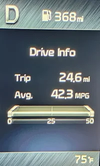

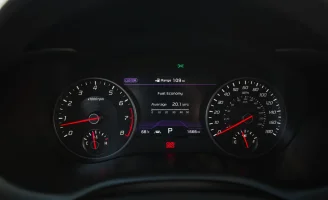

FWIW, the dash MPG displays I was referring to are not instant MPG. They are Trip AVERAGE MPG. On my '23, there are three(3) displays:
1. Trip Average Fuel Economy - this is a running average over the time/distance traveled since engine started. It auto-resets every time the ignition has turned OFF/ON.
2. Average Fuel Economy, since last refueling - this auto-resets every time ECU detects a substantial increase in fuel tank level.
3. Overall Trip Average Fuel Economy - running average, until driver manually resets.
For example, this screen shot shows the Trip Average Fuel Economy of 42.3 MPG over this particular drive distance of 24.6 miles, which is my commute route. This is the screen I drive on 95% of the time. On it, there is an instant fuel economy display, that is shown as a dynamic bar graph, It is also useful, but I don't always pay attention to that.

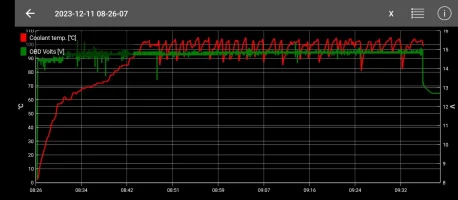

For clarification, higher charge voltage while decelerating (zero throttle), lower voltage while driving/accelerating (some throttle). - my car is a 2018, and does not have the Eco-coast feature.
Note, the variable charge voltage observed in this video is NOT what I see daily. It occurs "sometimes" , and usually in the warmer seasons.

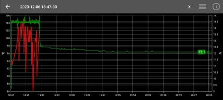

Recently, during colder weather, my voltages looks more like this image below, where voltage is basically consistent for the whole drive.
Voltage and coolant temperature plotted for about an hour.
Also, my battery resting voltage seems to be 12.1.... which does seem low!

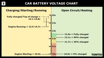

Those low-12v resting voltages really throw me though, as everything I've read about AGM batteries is that they should have pretty much the same levels as standard flooded lead-acid. 12.1v is about half full.
Battery voltage is not a good way to determine if electronics are working. Firstly, electronics around the car should work on a lot less than 12 volts. I would guess 5 volts. A 12 volt battery is meant to perform its work from 12 volts which is its nominal voltage down to say 10.8 volts or 1.8 volts per cell. (6 cells in a 12V battery). After that your battery is considered to be discharged or "flat". It's probably around that voltage that the starter motor will no longer work but the battery will continue to provide voltage down to zero basically. (Like after leaving your headlights on)
The float or charge voltage above 12 volts (2.25 volts per cell (13.5V) to 2.4 volts per cell (14.4V) is wiped off very quickly when the alternator stops charging so it's not really considered as part of the usable voltage. The battery will settle very closely to its nominal voltage or 12 volts. Then it starts to do its work if a load is connected to it. If there is no load, then the internal resistance of the battery will discharge it slowly over two to three months.
The battery's only function really however, is to start the car. The battery should not contribute in any way to running the car whilst the engine is running as that would be discharging the battery. It's the alternator's job to recharge the battery and run the load so everything should run from the regulated alternator output.
So I doubt that the alternator is disconnected (via a clutch for example) whilst the engine is running unless someone has proven otherwise. And even if that were the case, the battery would be discharging and require recharging creating additional load on the engine so it would create more fuel use.
Comments as to differences between flooded and AGM batteries. Both are lead acid batteries with sulphuric acid electrolyte. Flooded as the same suggests is flooded with liquid. The AGM, meaning Absorbed Glass Fibre Mat, has "starved" electrolyte, so it is still liquid, but it is suspended in a blotting arrangement between the plates which is the AGM or.....Absorbed Glass Fibre Mat...... That's all.
Not to be confused with "Gel" batteries which are at the really cheap end of the spectrum, 5ah, 7ah, home alarm batteries and the like, (it's still sulphuric acic), and you will also find Gel in very long, slow discharge batteries like Solar for example that use a tubular plate inside (much like your shelf in a fridge), so they need Gel to get around the tubes of lead. So these are expensive and high Ah like 500ah.
The only other difference with an AGM Battery is that it is "Sealed" apart from a vent that operates only if the battery is accidentally overcharged, sometime called VRLA or "Valve" Regulated Lead Acid.
The only real way to determine if a battery is fully charged is to perform a discharge test on it then recharge it.
Assuming the battery is around 100 amp hours for this car and typically a battery is rated at the 10 hour rate down to an end voltage of 1.8 volts per cell (10.8 volts).
So what you do is find a load of 10 amps, maybe some 12V light bulbs on a board, so that they draw 10 amps, and run the battery down for 10 hours. The reading of the battery should be 10.8 volts. That confirms the battery was at full capacity.
Now charge it back up at 10 amps for 10 hours......with a charger. It is back to full capacity.
If you try a higher load to do this faster, you will get a lot less amphours out of the battery and a lot less time. You do not get 5 hours with a load of 20 amps for example. It does not work that way. You might only get 3 hours.....so then it would become a "60 amp hour battery"......

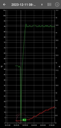

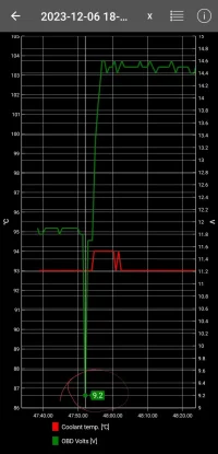

additional data from my 2018 stinger with OEM 90Ah AGM battery
During cranking, at 2°C (36°f), my voltage dips down to 8.2v - still cranks strong :thumbup:
Starting an already hot engine with coolant temp at 93°C (199°f), voltage dipped to 9.2v.
