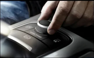

❈ It is recommended to turn off the Eco-Coasting system in the driving condition where frequent acceleration or deceleration is repeated.
Change the drive mode to COMFORT or SPORT mode, or disable Eco-Coasting mode on the AVN screen.

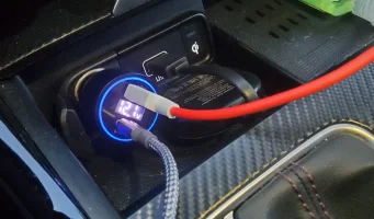

Get one of these and wonder no more.

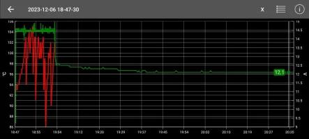

I drove home recently and left my ODBII BT adapter connected, and my voltage settled to 12.1v after some time.
Coolant temp in red
Voltage in green
Engine off when coolant temp stops, and voltage drops from 14.5
25 minutes after shutting off, voltage was 12.3v
12.1v seems to be my resting voltage at this temperature (about 0 °C)

Yeah it dropped about 25 degrees overnight here, and I measured 12.3v this morning. Ran some errands, maybe 15-20 miles of driving with two stops/restarts, and measured 12.35v when I got home.
Mine never works. I drive mostly short trips.
It will usually start working after a long commute. Maybe an hour or two of driving.
This would also point to it being a voltage/charge thing. I do some decent 30-45min drives which you'd think would be plenty to top it off.
I've never had anything that sounded like a slow or weak start, so wonder if the Stinger's voltage is supposed to wander a bit. But that runs counter to everything I know about lead acid batteries...

Ok, so I apologize in advance, but as a relatively new Stinger owner, this thread is the first I've heard of this coasting mode thing.
Is this something that the car does on it's own, or is it something I have to program or set up?
I looked through my owners manual and can't find any information on it. Maybe I'm not looking in the right place. IDK.
Thx.
Thx.
It may depend on the model you have. I am not familiar with the features of earlier models but the My23 Stinger has 5 settable drive modes by the knob in the centre console. 1. Smart. 2, Eco, 3. Comfort. 5. Sport. 5 Custom.
In Eco, the engine will disconnect from the transmission when there is no load, and "coasting" will appear in the centre display saving fuel. Essentially bringing the engine back to idle on a freeway for example. As soon as there is any change in braking, accelerating the transmission reconnects. You will feel it as slight nudge when it reconnects.
