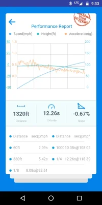

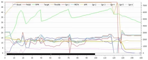

Quick run from tonight as it's nice and cold, 45F! Car is on a half tank of E40 and I ran map2 (no WMI), car is on the stock rims/tires, has our prototype intercooler, and a new suspension modification we're testing.
Hauling ass for such low boost! Tried a run on map3 and was able to get high fuel pressure to start dropping so definitely time to get back to work on fueling upgrades.

Deleted it but will be grabbing plenty more soon enough. High fuel pressure just starts dropping, when it gets to 7-8 in JB4 logs engine starts sputtering.
