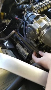

How am I suppose to manage the cables so they aren't in direct contact with the hot parts of the engine? I have 0 wiggle space on my wires.
No matter what I do, I cant get it to not be touching the intake manifold.
Does your intake manifold get hot?
Penguin If you will let go of the cable it will just hover a couple of inches off any motor parts...I put my cable inside a cheap spiral coax plastic to protect the cables if they touch something...as did you right?
just let it flop...or reroute the cable coming off the tray where the box is...that will give you more room...my cable is tie wrapped to strut ....if I cut it loose theres plenty of play off the motor :) Wash
They sit on the intake manifold which is plastic. You don't want them to hang so low they touch the hot turbo/exhaust/heat shield.
I was doing this right after I took the car for a test drive with the new intakes so everything was hot. Couldn't tell where was safe. I figured the plastic bits but since this part of the manifold is attached to the metal I wasnt sure how hot it got. But my plan is to zip tie it all right here.
Here is how I did :
