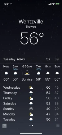

300 Hard Miles, 93 octane, no other mods. average outside temp 50 degrees. No issues to report.
