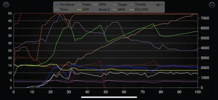

Newest log after fuel wire install. It took 4 times for Hex7 to upload without stopping.... but looks good.
@Terry@BMS my CSV file is on N54
