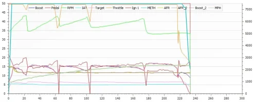

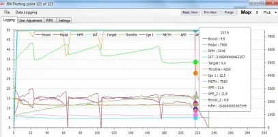

Log from a crazy Korean customer hitting is 160mph speed limiter on WMI, 60 additive.
again speed limiter is 167. There are plenty of videos already out there of people hitting it. But nice log!
Maybe. I'm just going by the data in the log, the ECU is reporting 158mph when it kicks in. What the speedo says in dash may vary.
I would expect those to also skew the ECU reading. Anyway whether the limiter is 158mph or 168mph it doens't matter much. I've never been over 155mph with it and don't plan to. lol
Is his IAT seriously only 51 degrees?!
It's probably pretty cold in SK right now. More so with 150mph wind swirling around.
You're right... high temps are in the mid / high 40s. Still, that's awesome with that much load on the engine! I'm sure WMI is helping quite a bit as well.
Any chance that the Korean market cars have different set speeds for the limiter?
Now that I think about it, the OBDII speed packet is one byte and in KMH. So it must just be maxing out at anything > 255 kmh (158mph). Makes more sense.
