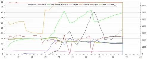

Managed to get a log of a launch control WOT - can u please have a quick look to see if all looks ok?
Yes looks normal to me!
