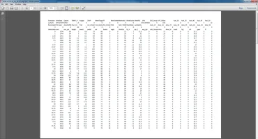

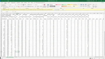

I took the car for a run this morning and logged you can see the CSV files on the link below on N54 tech.
Kia & Hyundai JB4 - Page 45 - N54Tech.com - International Turbo Racing Discussion

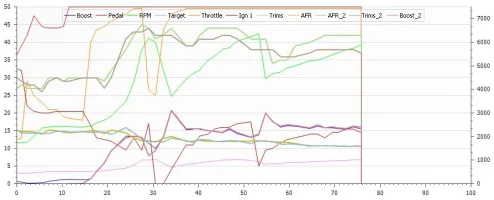

I'm running Map 5 with 30% plus of ethanol with fuel wires and the V6 firmware and the car only spun the wheels a little of launch the below snap shot is taking of with launch control.
Appreciate peoples thoughts to work out what may be wrong
I know approximately nothing about reading logs but I'm guessing that most of the run being under 10psi with a max of 15 might be the culprit?
*edit* I'm probably looking in the wrong column. Ignore me.
Isn't that jump from 10 - 20 psi at ~3000-~3400 RPM not good? I don't have much experience tuning this car but I would think fluctuating 10 pounds is abnormal?
I know approximately slightly a little bit about reading logs and I don't see an issue. The timing curve looks good, boost is hitting ~17psi (in the 3rd log), and AFRs look good. D-C maybe you're just used to the power...
Help me understand.
For psi you're looking in the ecu_psi or boost column?
Boost and boost2. ECU psi is the fake data that the jb4 is sending to the ECU to make it think it's at stock levels.
@D-C you definitely pull some timing at the boost spikes, I’d let Terry check but you might want to put some fuel back in up top around 5500-6200 range and pull a slight touch of timing.
It’s not “bad” but I would think that could be better.
Also you played with the boost by gear setting? Looks like there’s lower boost in the lower gear.

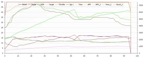

I didn't think I had changed anything for boost by gear but must have done something, Is that map 6 boost ? or where would I change the boost bye gear ? looks like my 3rd to 4th gear pull has much higher boost.

Logs seem fine to me, maybe those springs are helping with traction? Are you shifting manually or letting it shift? Get a dragy and do some 1/4 mile and 0-60 runs to see if it's putting down the power!

Do you know how to turn of the boost by gear ?
It's off, boost by gear on user adjustment page. Enjoy the traction, I wish I had it.
As above, it looks to be off.... you on the stock tires. Man, I dunno.... it’s better to hook and go for sure.
