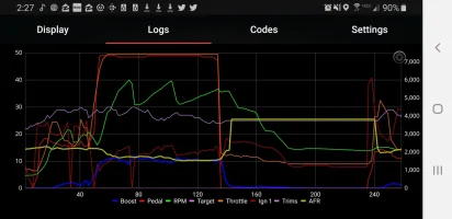

Terry one descent log made of a long pull map 0. Factory intakes stock plugs both about to be changed. How does everything look? Can I start trying map 1 and 2 when plugs are changed? Also is best to give you logs att full throttle or longer partial throttle for review? Are fuel wires working correctly?Screenshot_20191207-142720_JB4 Mobile.webp
Looks normal to me. Should be no problem on map2 once plugs are done as fuel quality appears decent here.
