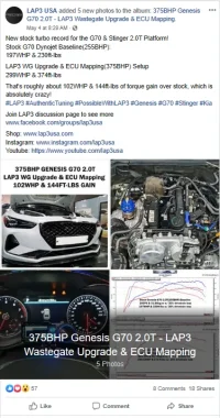

There aren't many flash tunes out for the 2L. Believe Tork Motorsports has one out and Lap3 is working on a wastegate upgrade & tune, but it doesn't say when it will be available.
I had a jb4 on my 18 premium for months and enjoyed the additional power, I recently upgraded to a 19 GT2 and will be reinstalling my jb4 soon.
Those are nutzo gains on the Lap3. Will be keeping my eye on that.
