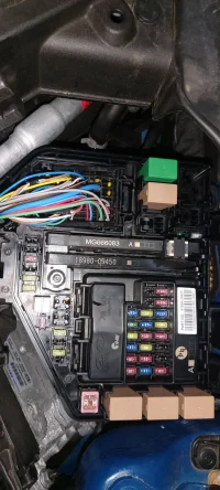

Two new 25amp fuses replace the original 40amp fuses on a multi-fuse bar in the engine bay. Attached are some photos for other curious Stinger owners showing the new fuses & replacement fuse box cover date stamped Feb 2021. Seems like a neat & efficient plug 'n' play solution to me.
I had mine done today too. No before photos but it also looks like the wiring loom was spliced with glue-lined heatshink?
They also said they were going to update firmware in the process too. Took less than an hour all up.
Interesting to see they chose to replace the fuse box lid entirely too. I would've thought they could've just stuck a heavy duty vinyl sticker over the old diagram?
