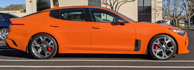

excellent look you have there. I’m convinced and sold.Ok, so I had them installed today. I am currently 26.75" front and rear. (With a couple of gallons), so that's a 1" drop on front and 0.75" drop on the rear from my original measurements. 20" Rims / AWD.
On my drive home from work, which is pretty much stuck in traffic then highway driving, I noticed very little difference from stock with regards to comfort. I'll get a chance to test them more in the coming days and follow up. Overall the drop was exactly what I was going for, not too extreme but enough to close those gaps.
Considering your measurements, i'm wondering if mine will drop anymore in the coming days with more driving? I'm going to wait a week or so before I get my alignment.
Now what everyone's waiting for, the before and afterApologies, quality could have been better as well as outside with more light. View attachment 26932 View attachment 26933 View attachment 26934 View attachment 26935 View attachment 26936 View attachment 26937
