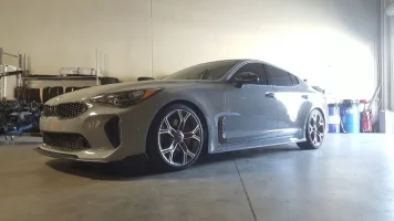

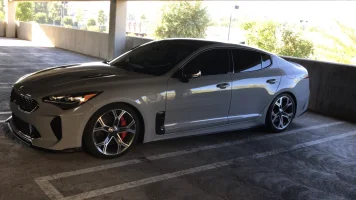

Ok, so I had them installed today. I am currently 26.75" front and rear. (With a couple of gallons), so that's a 1" drop on front and 0.75" drop on the rear from my original measurements. 20" Rims / AWD.
On my drive home from work, which is pretty much stuck in traffic then highway driving, I noticed very little difference from stock with regards to comfort. I'll get a chance to test them more in the coming days and follow up. Overall the drop was exactly what I was going for, not too extreme but enough to close those gaps.

Now what everyone's waiting for, the before and after :D Apologies, quality could have been better as well as outside with more light. 01Frontandrearbeforelower.webp 02Frontandrearafterlower.webp 03Frontbeforelower.webp 04Frontafterlower2.webp 05Rearbeforelower.webp 06Rearafterlower2.webp

I'm not into slammed cars, but this seems pretty subtle and fills the wheel wells better.

There is very little difference with regards to Comfort from Stock. I doubt anyone other than you will notice any difference.
