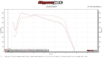

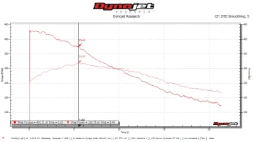

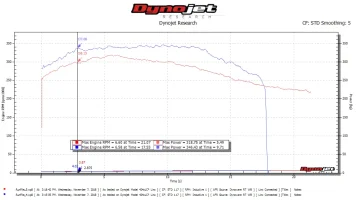

Graphs coming shortly. Actual best tuned wheel torque was 430, and whp was 383.

Why is the power dropping off so early? Looks like there's no top end.
... or am I reading that wrong?
it's a weird graph, why is the x axis time and not RPM?
For a number of reasons:
Dyno operator didn't turn off the ESC or stability controls so the nanny's got in the way
Dyno operator failed to realize it is an eight speed tranny, hence 5th gear equals 1:1
Dyno operator didn't realize that by pressing the accelerator pedal too far, he hit the kick down switch, thus changing gears
Dyno learned as much as I did in the process.
It was an unprofessional experience. Yet considering it is a school with a garage that has only been opened a year, it was still beneficial in being able to quantify the power. They've had the Dyno for four months. I don't think they've done many Privately owned autos, just a few tests to train on it.
