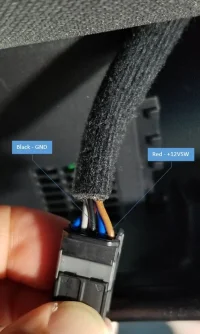

Anyone hardwire a radar detector yet?
I can confirm that it is indeed red wire to Ignition (Pin 6) and black wire to Ground (Pin 10), now I just need to affix the wiring somehow... I may end up just taking it in somewhere to have it done well after all.
That’s a double positive. Nothing positive is going to happen then.
Use one positive and one ground.
Battery + is continuous on
Ignition is + only on when ignition is on.
So it is black on 8
Red on 10 ( might drain your battery if detector stays on )
Or
Red on 6
Or
Ask someone to help who knows what he is doing.....
I hope this helps...

I just tried to tap the #6 (power 12v) and #8 (ground) pins on a non-homelink mirror and the power is switched with the ignition BUT it loses power when the headlights are off??? If my headlights are in auto mode the unit works in the garage (dark) but as soon as I hit the daylight no power. Anybody have a schematic for a non-homelink mirror?
Edit: I moved it to the #10 pin and all works as it should
I just finally got around to mounting my V1. I had the middle size MirrorTap kit, but I'd recommend the smaller one. It was a tight fit. I can also confirm you want 6 and 8.

So what's the verdict on this? Wires 6 and 8? 6 being positive, ignition controlled and 8 being ground?

So I hardwired my Escort iX. It is wires 6 and 8 that let the detector be controlled by the ignition.
I used this hardwire: https://www.amazon.com/gp/product/B078956R2S
And I used this wire connector and it fit perfectly: https://www.amazon.com/gp/product/B075L586QP
Connector pic 1:
Connector pic 2:
Connector seated:
Radar detector plugged in:

Connector was easy to get to and unplug. Attached the Posi Taps to wire #6 (brown) +12v and #8 (black) ground. Wrapped the hot from my dash cam and radar detector together and attached them. Wrapped the ground from each together and attached them. Checked everything visually, plugged the connector in. Checked that both dash cam and radar detector work correctly and shut off when the car does. Total time maybe 10 minutes. Took about 2 hours on my Ranger pickup.

First, my goal was to tap once using the given connections provided by Blenmount's wire kit, they wouldn't slide into the mirror connector to tight, I returned it since it was pricy and got the amazon one and tried it as well and the same issue.
I then cut the ends off and I soldered on some additional wire and shrink tubed it. The purpose of this was to tap one time into the car's wires using the above wiretap which works great and leave myself 2 connections 1 for the radar detector and one for a dash cam once I decide which one I want so now I have an extra set of wires ready to go when I decide on it to connect to.
As said in previous posts on the 2019 GT2 the wires are brown for ignition and black for ground. Pretty quick and easy and plenty of room to put your tap and wire there.
