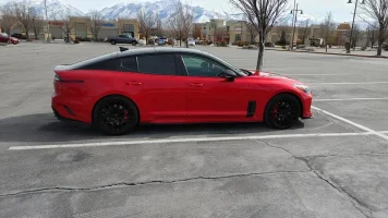

I did exactly this at +35, 8.5’s all around That way I can get the same size tires later and be able to rotate the tires.
19x9.5
I haven't seen anyone else on these wheels, just put them on Friday.
AVID1 AV20 19x8.5 +35mm in Black
Continental ExtremeContact DWS06 225/40ZR19 Square Setup
