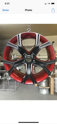

Indeed, and I do not have a red interior.
Problem is a slight fixation on red on my part...witness the gratuitous usage of red silicone for a couple of the hoses connecting my intakes. That may creep to other areas of the engine bay. Could do some blue hoses too, maybe some wire loom. The Team USA vibe.
Avoiding solid red wheels because I don't want to be Santa's Stinger. Too much work getting reindeer bits out of the grill.
I dig the red accent wheels.
On your white, it’ll look nice. Wrap you mirrors/vents/front grill surrounds red too!!!
Still "itching" to see a set of Weld's on a Stinger....like the S77s or S71s Forged.
If it aint broke, dont fix it...just tweak it!
