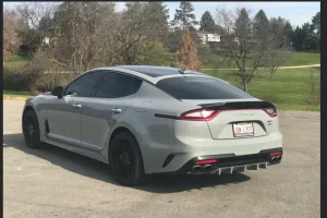

These pics are 20x10.5 on +45 285s lowered, for reference.

The front are +35 20x9 on a 245.
I can't really compare traction vs stock since I did a few more mods right around the time I installed the wheels.

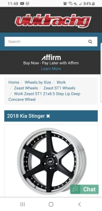

Does anyone know the specs on those Work Zeast ST1? I've pretty much decided that's the setup for me...Granted with quite a bit less lowering

Uuu definitely show us pictures if you go for it :thumbup::thumbup::thumbup:

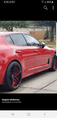

Verde Axis 19"

I'm looking at rims and keep coming back to the matte graphite Axis V99.
Did you install the stock TPMS sensors and do you have any interference between them and the calipers? Also, can you take a side profile pic of the fronts and rears? I'd like to see how flush they are.
Thanks!!

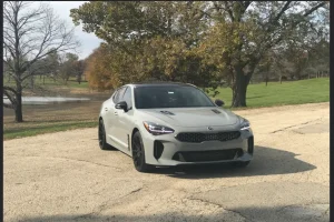

Ark 270’s 19x9.5+25 square. Powder coated in “Black Jack”. Pilot Sport 4s 255/35/19 square. Eibach springs. AWD

Here are the 19 inch Vertini RF 1.3 Gloss black
