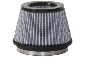

That link isn't working for me... Here is another link directly to the filter from Jegs.
Edit: since I'm too new it won't let me post links. Just go to Jegs and search for the filter P/N 21-2093DK
Inlet flange: 6" diameter
Base of cone: 7.375"
Top of cone: 4.78"
Height: 4"
More filter surface area is always a good thing. Both for flow, and for dirt capacity. Gonna look and see if there are any other filters that would fit. That said, if you had to guess, about how much room do you have between the end of the filter and the firewall? A taller filter would be good if possible!

Thanks for the response! Here are a couple filters I found that may fit the bill...
1 - afe filter. You can find it at summit racing, look for part number: afe-21-91054
This is 5" tall. Has a 5.5" diameter top end. Also a 7.5" diameter base (same 6" inlet flange, though).
2 - K&N dry flow filter. I found this one directly from K&N's website. P/N RU-3106HBK
This one is a tiny bit shorter than the first filter at 4.8". Top diameter is 5.25", and base diameter is 7.5" (again, has a 6" flange).
May have to do a bit of tweaking to make them fit....IF they even fit in the first place. I'm tempted to buy the AEM intake and buy the first filter and see if I can get it to work. If not, then return it.

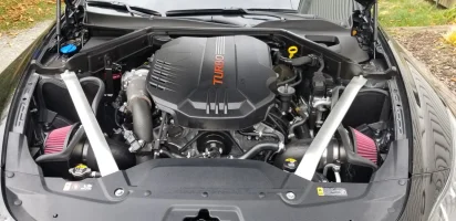

Just installed the AEM kit on my 2021 GT1. The sound, the first time I got got on it, scared the sh*t out of me! Looking forward to tomorrow's cold start. :) Working for the manufacturer has it's perks. Had my choice of the AEM or K&N and chose the AEM for the molded black pipes looking closer to OE and higher HO/TQ. Came from a tuned Mustang Ecoboost Premium and this car is just incredible!

When I did mine it was a couple of hours, mainly cause of how tight a fit everything is. Reaching down to where the intakes hookup to the turbos is a pain.
Do the Plastic NPT fittings(couplers) on the driver side tighten all the way down or do threads show?
Gave AEM a call to ask. Customer service on the other end was as useless as tits on a bull. Definitely had no idea what I was talking about our what the answer was. Said that the posts break easy so be careful. WTF. What would it have cost for AEM to supply couplers with metal threading.
Any way. Took me about an hour and half to get everything installed. Was actually easier than I expected.
