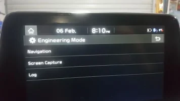

Since the latest SatNav update; the original screen-saver method no longer works.
However the new process seems to be:
1) Go to Settings > Version
2) Tap 4 times on the Map text THEN tap the actual map version number. (Sequence also works against the firmware text & version number)
3) The PIN prompt then appears and now I now have no idea what it is. :(
1111 as seen on other Kia/Hyundai forums doesn't work (which tipped me off to this process)
0000, 1234, time in 12 & 24hr, date ddmm, mmdd, mmyy, same with the update date in similar fashion are all no go.

I'm in :D
The new code is 2998
As per my post above; access via the settings > about menu. Click the "map" text 4 times; then click the map version number text.
The bad news is there's less options & no Android menu compared to last year's firmware.
