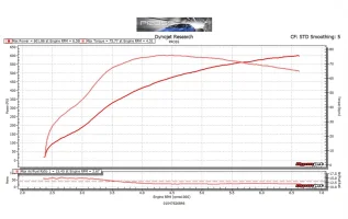

@LAP3 Tuning why was the first dyno 620whp but the final was 590whp?
I think thats where the finalized maping of the ECU was set at.
Yea, but why? For safety? Was there some limit they were worried about? Was too much timing being pulled? Fuel pressure dropoffs?
We left a bit of cushion as customers in Korea race up to anywhere between 150-200mph.
It's the race culture Koreans have, and they don't really care for 1/4 mile times. Especially when the track isn't open for everybody.

I have the finalized dyno sheet forwarded from our office in Korea.
601.86ps & 75.77kgm
593 WHP & 548 FT-LBS of torque
The LAP3 XT26 Turbo Upgrade offers amazing spool up time.
Lots of power and torque throughout the powerband, and 500WHP is reached before 5000RPM.
As always, LAP3 tuning comes with extremely clean and smooth power delivery as you can see from the dyno.
