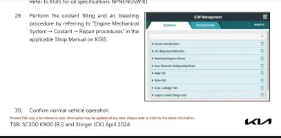

Hi all, I don't post here often. But I just got my recall done today and I want to give you guys a heads up. Make sure when they put it back together that they bleed out the coolant correctly. My wife picked up our car and got 2 miles away and the car started over heating. Called Kia and they sent a tow truck and after said there was an air bubble in the coolant line. This was at Layton Kia in Utah.
Almost like they completely skipped step number #29
If anyone is curious, the refilling / air bleeding is attached
