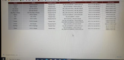

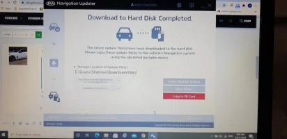

Although i'd already completed the upgrade i went to that site more out of curiosity and successfully downloaded to hard drive. Next step would be to copy to SD then install in car. Site was very easy to use and doesn't require user registration or vehicle VIN. Seems it caters for all KIA models that use an SD card.
Adam, suggest you delete your first attempt and try again.

Yep, I managed to get it working by removing the SD card from my PC. Then it allowed me to select a version (I used CK_19MY.AUS.SOP.004.1.190403.STD_M) and download to SSD. So much easier to use than the older Smart Update Manager software.
They must also be pointing at different servers with the newer app, as the SUM update download maxed out at 5MB/s, but with the new one I got over 50MB/s and downloaded in around two minutes.

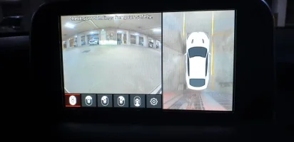

Is this new? Or perhaps i just hadn't see it before.

I’ll say new, don’t recall seeing that before, which now confirms what another member said about 360 camera being brighter.
Where did you find this?

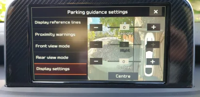

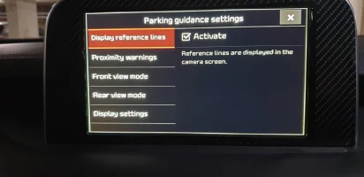

When camera view is on there's a settings icon in bottom right that brings up another menu. Select "Display Settings" and you have options to change brightness and contrast for day/night.
Thanks mate found it, no I don’t recall seeing that before, I note the night adjustment is greyed out, may have to adjust when it’s night.

I did night in basement carpark, set brightness and contrast to max. Seems to make a big difference.
