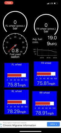

Ok so my scanner arrived, I did some testing and I couldn’t find much of a difference between wheel speeds when the TC activated. Most of the time, FL sensor would be a bit different than FR sensor but it would immediately go back to the same speeds. Vise versa. It wasn’t anything too noticeable to be a reason why TC was kicking in. Also, front and rear sensors show two very different speeds. As you can see in this picture:
I was going at 80 mph in cruise control when I took this screenshot
Is there any other modes or setups you would recommend trying?

I think you have your answer as to what is happening. You need to figure out why the front and rear axles are showing different speeds. To me, it looks like the rolling diameter of the rear tires is less than what the car “thinks” they are.
I still agree with this. Please confirm rear tires are 255/35/19. That is the stock size. It would be unlikely for both rear sensors to be busted at the same time.
and the fronts need to be 225/40/19, because that could be the problem too.
are the tires the same brand and model? One manufacturer’s 255/35/19 is not necessarily the same as another’s. I learned that the hard way On a different car.

It would also be nice to confirm tire pressures for both front and rear. Over/under inflation can affect rolling diameter and hence apparent speed.

Possible, but it’d have to be a huge difference in pressure for it to have that much of an effect. I suspect he’s actually got 225/45s up front or 255/30s in the back, or he changed wheel diameters on one of the axles and thinks 225/40/19=225/40/20 (for example.)
