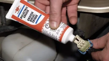

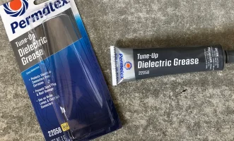

It may be wise to add some dielectric grease to the connector, to help maintain a good clean contact
something like
contact resistance with Nyogel - no difference from naked.
