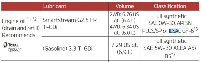

The transfer case is in the way I think. I'd say the #'s are pretty close. Eye balling the 5 qt jugs, I have ~ 3 2/3's qts left from the 2nd container. What I'm confused about is why isn't 5w-30 an option for the 2.5, aside from mpg.
I'm a big fan of pennzoil ultra platinum, which is api SP ilsac gf-6a compliant.

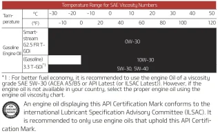

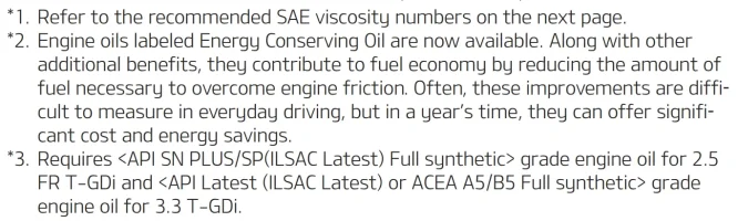

The manual is showing both of them as acceptable weights. So maybe they provide better protection for the price of lower mpg. Not an expert here.

Counterpoint (?): all oil types show as being appropriate through quite high ambient temps. If true, why use a heavier-weight oil? It will just cause more parasitic power loss. (But possible counterpoint to my counterpoint: parasitic loss could be so trivial that it only makes a difference in fleet-wide calculations needed for US CAFE standards.)
