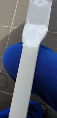

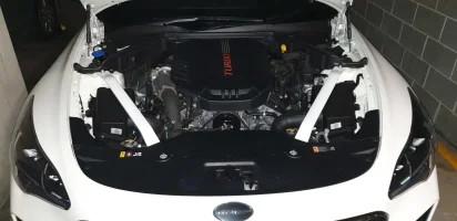

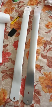

Wrapped braces last month

I used Avery SWF109 wrap as it's a near match to body colour. A sheet of vinyl from a craft sbop would probably do but getting it to look good around the curved parts might be challenging. Proper car wrap is so easy to work with.

So I made small cuts with an Xacto knife on the sides when bends begin.
I did it on a hot day/in the sun to help wrap be more flexible.
I would have someone hold the bar while wrapping (or use a c clamp next time ;) )
I painted the bolts (and any gaps) with enamel model paint ;)
I would recommend using a washer under the bolt heads - it 'warped' the wrap when torqued down.
Overall - I'm very pleased with how it turned out.
