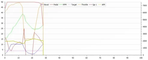

So tonight I was out having some fun just driving around. Took a turn from a stop at WOT trying to kick the backend out and burn a bit of rubber. Stability and traction control disabled moments before manually. Start spinning tires a bit and the backend starts to lose traction. Wide open throttle here. Car completely cuts throttle and I lose power for at least a second with the pedal to the floor. The f*ck? Ok.
Using JB4 Map2, maybe something is going wrong. Check my logs. Something I don't know about is definitely happening. Logs look crazy. Let's set her to map0 and test again. Make sure I turn off traction and stability control again. Same exact thing. Is there something I don't know about going on here? Is this harmful to the car? Anyone have any clue wtf is going on?
Maybe I'm dumb, but I've never had a sports car I couldn't burn a little rubber in. Is this the same for everyone else? Has anyone tried drifting this car a bit?
Attached. Map0 log of 80%+ throttle 90 degree turn.
Only mods I have are densos gapped to .022 and a JB4 which I set to map0 for the test.

I don't think that it's temperature dependent. I've tried this in warmer weather with the same results. I think, once wheelspin and excessive yaw are detected, the nannies kick back in.
Did it happen when the speedometer read 35 mph?
No way. DIdn't see exact speed but as you can see from the log, I barely even got going and it shut me down. I couldn't have been doing more than like 20.

The car may be moving at a speed much lower than 35 mph, but wheel speed sensors might be reading 35 mph or over which what the speedometer would display. In GM full-size pick up trucks, the stability control reactivates and cannot be turned off at a minimum speed of 35 mph; the stability control in my Stinger stays defeated at any speed but I have not tried to push the car beyond traction limits to see if it will be reactivated.

Looks like DSC from tire spin to me (see how MPH ramps up quickly). You can disable the straight line traction but once turns are involved it does not have a disable option on this car sadly. Makes doing doughnuts difficult. =/

I started a thread about this a couple weeks ago. It seems like the nannies never full disable. I even find that I can sometimes get the car to step out more with the nannies on then when they are off. It seems inconsistent as to how and when they want to step in and take over.

All the vehicles i have bought in the last ten years have safeguards in place to limit wheel spin based on steering wheel angle.... Unless that sensor is defeated you will always see this.
