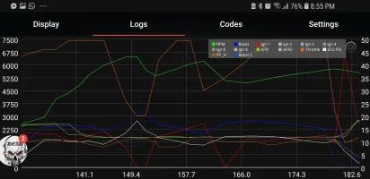

I've had slightly similar issues, on occasion but only in initial spool, it levels out to normal levels of 19ish psi on map 3 jb4 in weather around 30-40 f. Given the snow and I live in the city, I've not had occasion to get hard runs in to see if I'm having the same level of issues that op is having. I'm going to try to get some runs in this -15 c weather and see what happens. Attached is screen cap of what we are discussing

Warmer weather and a higher boost target setting in the piggy back will likely suppress the issue hence why people in warmer temps may not see it. But since the lap3/ flash tune guys don't have advanced logging they might not know it's even happening.

Have maybe 20 JB4 cars running catless without issue. When there is an over boost issue that needs to be resolved it's 2-3psi not the 10psi+ OP is seeing, so I suspect he has a hardware issue like the WG arm movement is blocked or seized.
The JB4 is more advanced than all of the other piggybacks out including Lap3Pro and the JB4 can control WGDC directly in both banks. We do it on many BMW applications including the //M models. But we do not have that feature/wiring implemented on the Stinger yet. No other Stinger piggyback offers WGDC control. So if WGDC really needs to be dramatically reduced on this car the only way to do that currently would be to directly adjust the WGDC base tables in the flash/ECU itself.
This is a different issue than the usual 2-3psi over boost we see and can tune around using the JB4's IAT spoofing. I suspect one of his wastegates are physically blocked shut or something bizarre is going on. On stock tuning it's hitting 24psi at half throttle.
Stock tunning its hitting 20 psi. Map 2 has hit 24 psi and Map 3 today hit 25 psi.
