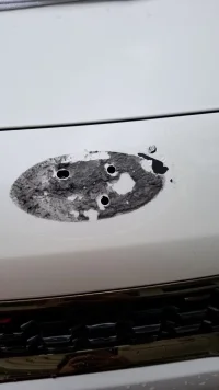

I know this issue is partly my fault but I feel like it was a bad paint job to begin with. I was wondering if anyone had the same issues.
I ordered the E badge, E wheels, and the rear Stinger logo from this site. Considering I've taken off emblems with no problems before I figured I can do this. Now it looks like I need a new paint job.

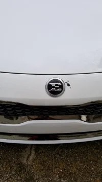

For the front, I used a heat gun. Kept it at a distance. Even placed my hand near the edge of the emblem to give me an early indicator if I am heating it too much. Left side came off, no issues. The right side however, ended up bubbling. It actually bubbled under my hand. So I didn't even see it till I took my hand away. I didn't know what to do with it so I left it. And after going to run an errand I see that a huge piece of paint just flew off and now I have a big black spot.

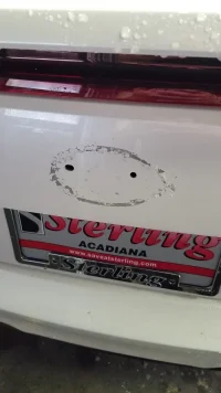

For the rear, the stinger came off no issues using the same method. The main Kia logo however is another story. I heated it up, no bubbling. I stuck some fishing line in and sawed it like I did with the front. I started seeing white chips hanging onto my line. Once I took the emblem off, I saw that the entire outline of the logo was missing paint. So now I have a big oval of missing paint.
I will attach some photos soon but I've never had any issues like this taking off emblems on my bmws. Now it looks like I'll have to pay a body shop more than it would of cost me to have them change emblems.

I'm not defending Kia here, just offering some experience having run a new car dealership for 10 years. White paint, for some reason, has always had a bonding problem. If you look at all the vehicles on the road with peeling paint, especially work trucks and older GM and Mercedes cars, you'll see about 10:1 white paint bonding problem compared to all other colors combined. Silver is another bad color but most of the silver problems come from customer lack of maintenance. I would hope Kia would stand behind the paint, but I can understand if they don't.
The front area where badge is located is made of plastic and paint does not adhere well. The heat gun made it worse.

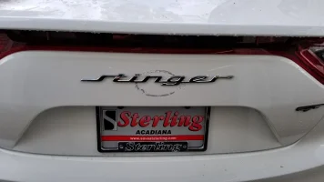

Hopefully the body shop does a good job and I am not noticing a slightly off color white everytime I look at my car. Here's the pics.20180317_154905.webp 20180317_140800.webp 20180317_142720.webp 20180317_152341.webp

Hopefully the body shop does a good job and I am not noticing a slightly off color white everytime I look at my car. Here's the pics.View attachment 4884 View attachment 4885 View attachment 4886 View attachment 4883

You wont be happy with a touch up pen. It may not be noticeable to others far away, but I think it will bug the hell out of you. I went to one professional body shop and they quoted me $500 for something just like yours on the front.
I bought some aerosol cans from automotive touch up. Sand/Scuffed the area and repainted it this weekend. It is quite time consuming if you want the paint to be blended in nicely. It was my first attempt on my new car, would I do it again if I had to? Probably not.
In your situation I would seek out a professional shop.
