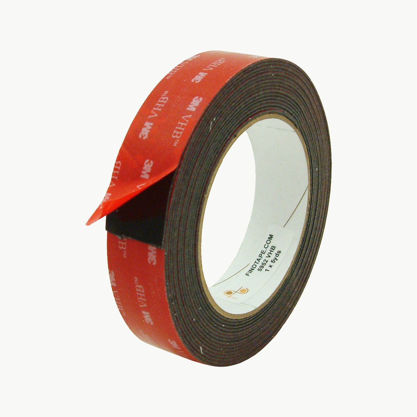

Cutting that tape so that it’s not visible behind here I think isn’t worth the effort, the tape itself isn’t cheap, the badge not much more so. If you trust yourself to scribe the tape and cut it to shape by all means, go for it, but it's obviously not going to be as simple as cutting it to length and plastering it to the back of the car. The tape comes double sided, one side sticky, and one side to peel off.
You'll need to apply the sticky side to the back of the stinger badge, then cut the sticky side with an xacto knife, the blade will stick to the tape as you cut, be careful not to cut the plastic badge, but cut very close so that the tape isn't visible once applied to the car, as you can see from the picture the OEM badge adhesive is recessed by about 1mm around the edge, but after cutting it'll be right up to the edge.
Personally, I don't think it'll turn out well and you'll end up ordering a new badge anyway ;)
2018 Kia Stinger Parts - Nameplate - 86312J5100
https://www.amazon.com/3M-Scotch-59...ywords=3m+vhb&qid=1559056070&s=gateway&sr=8-3
Happy with mine.. and used a fraction of the original amount of tape..

Problem is that one side of that tape is always sticky, you have to stick it to something as soon as it comes off the roll, so really the only option is to stick it to the badge first, then cut it out around the badge.
