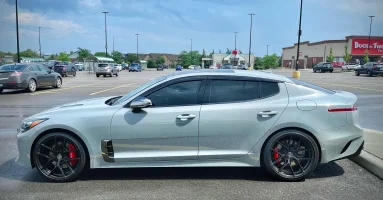

Fronts will clear struts and will be fine. Rear 285/30/20 with 20x10 +40 may rub on dips depending on the tire. Mine was 20x10 +45 (+40 with 5mm spacer) and it rubbed slightly on dips on the highway with Michelin PS AS3+ tires. I’ve since gone back to 20x10 +45 and no rubbing at all now. The tire is completely flush with the top of the fender aswell.
