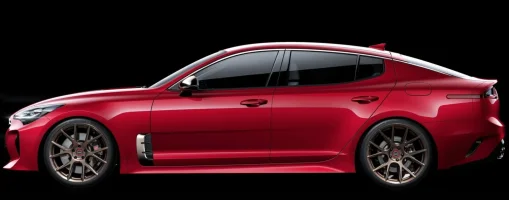

Ordered a set of Vossen VFS-6 's for next summer, gonna take a while for them to arrive.
Gonna be running 20x8.5 et32 in the front and 20x10.5 et45 in the back. Wheels probably gonna be 245/35 in the front and 275/35 in the back. Their gonna arrive as plain but the same guy who ordered them does professional painting and final result will be something like the pictures.
Gonna add KW springs to lower also and then possibly add Ingo Noak full bodykit also.
