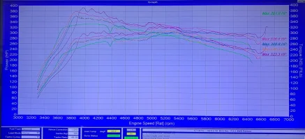

Any overboosting issues seem to be fixed by adding a jb4 and hks plugs. The primary downpipes seem to net the best gain as far as downpipe set ups go and the UP Combo Kit will have no cel issues but smog inspections will vary from state to state.
