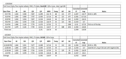

Here are my tests before and after Mids. Be sure to do correction for DA.
Absolutely no change unfortunately.

Mine was secondary with cat back.
Primaries should do 15 -20 HP if the rest of the exhaust is also replaced. The +3 HP exhaust dyno for Primary was with all the rest stock exhaust.
Oh ok. Then I agree. Secondary downpipes only increase the sound. People who say they add performance are liars.
