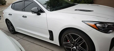

Fortunately, the side vents and hood vents that I got were the real thing and not Chinese knockoffs. They had KIA part numbers on them. They fit perfectly.
Those do look nice. Where did you get them from? If they have a Kia part number, I wonder if they are from the American GTS

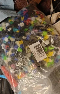

That's a lot of missing clips! Are you going to have a bag of them before you do this?
who did you buy the vents from?
Oddly enough, I can't remember off the top of my head. It's a senior moment....haha. This was over a year ago.
I'll have to go back through my records. Patience plse....lol.

Those pics are from eBay, not from my car. I hope to not have any missing or broken clips when it's all said and done

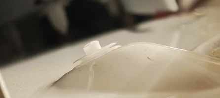

The license plate bulb repair job is complete and successful. Found out some very interesting things along the way...

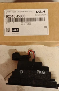

New left hand bulb part number as they're not identical:

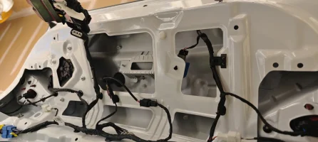

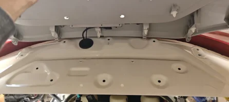

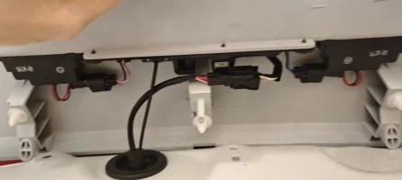

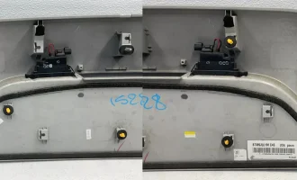

Removed the interior hatch panel, as you can see there is no access to reach the bulbs from the inside:

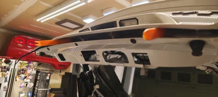

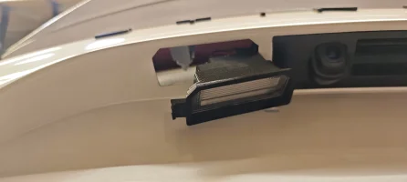

Beginning the process of popping off the exterior panel:
Pops off pretty easily, actually...

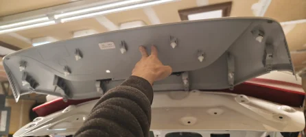

...but I lost two of the pins in the process:
Luckily I had a bag of about 1000 replacements and the ones that broke off were in there:
Here's how the bulbs mount, just clip in:
Popped out:
Confirmed inop:

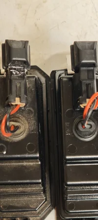

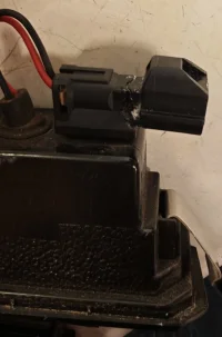

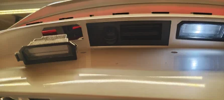

Here's where it gets interesting. This is the old light:
Old and new:
It appears obvious to me that the body shop super glued the connection back together instead of replacing the light with a new one. I am not sure if the old light was working after they glued it and then failed within the last couple of weeks or if it never worked and they thought they could get away with rigging it up like this.
My wife was pretty upset at my findings so she is going to go back to the shop tomorrow and give them a piece of her mind. I for one just wanted the issue fixed but you guys probably know how women can be. Who knows, maybe they'll reimburse me for my out of pocket expense to replace the bulb...but my labor is free

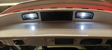

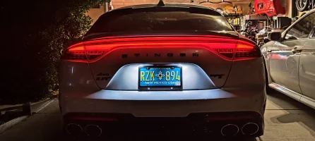

Confirmed working:
All better now:
Great job! Was that white outside panel screwed in somewhere, or was it just held in place by clips?

Confirmed working:
All better now:
Popped out:
Confirmed inop:
Old and new:
Confirmed working:
All better now:
Thank you so much! Now I know for certain that I am not touching any of this. Interior hatch panel off too! You didn't say that the first time. Looks like the hatch latch gets removed also? Can't tell from what you said and showed. Doesn't matter, I won't be doing any of this, ever. No tools. No clips. I guess this design isn't particularly stupid. Probably other cars are just as unfriendly or more so.
