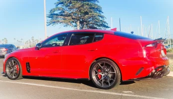

My son used my car to take pics for his friend that is an aspiring automotive photographer. This pic was before my car was in the body shop 2 years ago. If you zoom in you can see the light is on.

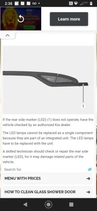

Do some of them though? What am I seeing here from an online listing for the part.

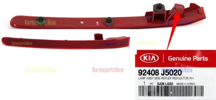

Is this just a mechanical fastening for the tail light to connect to the reflector? - My 2018 model does not have any illumination in the side reflector.
The reflector strip does not contain the little side light. That is a forward projecting bit on the taillight assembly, that inserts behind the hanging/rear end of the reflector strip. It must be an LED, there's no space for a bulb.
So you're saying this is part of the tail lights?

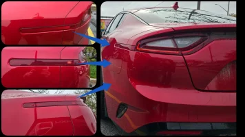

There is for sure, LEDs in there. But with a very tight beam angle.
Standing right beside my car, without bending down, I can NOT see any light
Squatting down, and sure enough... There it is.
The middle and lower picture below, can see LED.
Top picture, can not see anything.
Very small beam angle

Yes, the LED is part of the taillight assembly, at least on the '18 and '19 that we have. I can't believe that KIA took the side reflector light out of refresh taillight assemblies. You must have a disconnection issue? But both sides at once?
