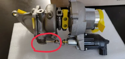

The noise is comming from where the wastegate actuator arm meets the turbo housing, if you spray it with rust off it will remove the noise. So far mine has been 30 mins no noise, most likely will come back. Also after i removed the noise from the RH side, I noticed the left side had the exact same noise. I would like Genesis/Hyundai/Kia to update the turbos for this noise before i replace them.
Is this the specific part of the actuator arm you're referring to? If so, I can see how that thing would get squeaky.
