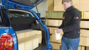

ADAC (German Automobil Club) measures with different blocks
The method sounds objective but in the opinion of the ADAC it is only conditionally practicable. For this reason, the automotive club has set itself the task of finding better orientation values with one-liter cuboids in the DIN dimensions during its own vehicle tests. "Small compartments, which are not usable for luggage, we calculate separately," says ADAC engineer Martin Ruhdorfer. These include double bottoms or stowages in the side panels of the trunk.
Their volume is not added to the main storage space. "It is better for the car owner to be specified less, but really usable storage volume."

It depends on the shape of the block (cuboid) measurement
A better idea of the usable storage space is given to consumers by means of the cuboid dimension, which is stated in maximum
usable height, width and depth. However, it does not necessarily appear in the brochures of the manufacturers, Ruhdorfer has stated.
The ADAC measures the trunk of cars with foam bricks

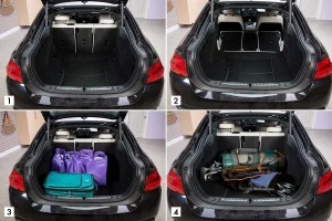

And last but not least, a side profile comparison of the usual suspects. It's hard to say which car has the objective advantage - never mind the manufacturers data, but my vote would go for the Porsche, after all it's the longest of the bunch and has a fairly rounded stern.
WB  114.4”  L  190.2”    H  55.1”
WB  110.7”  L  185.5”    H  54.8”
WB  110.6”   L  182.5”    H  54.6”
WB  116.1”   L  198.8“”    H  56.0”
