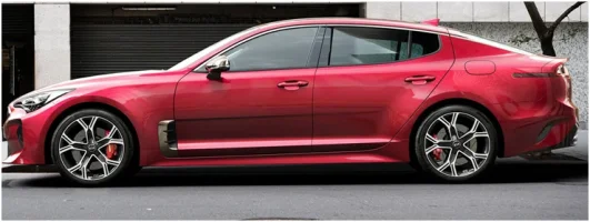

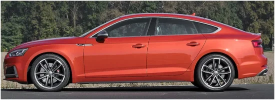

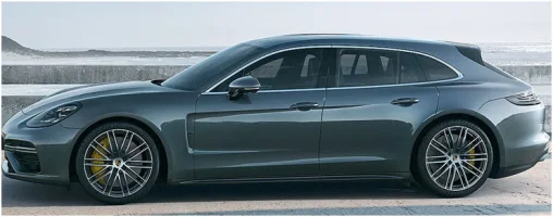

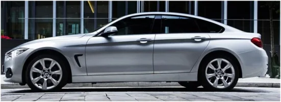

And last but not least, a side profile comparison of the usual suspects. It's hard to say which car has the objective advantage - never mind the manufacturers data, but my vote would go for the Porsche, after all it's the longest of the bunch and has a fairly rounded stern.
WB 114.4” L 190.2” H 55.1”
WB 110.7” L 185.5” H 54.8”
WB 110.6” L 182.5” H 54.6”
WB 116.1” L 198.8“” H 56.0”
Bottom line is, you have to take out the tape and measure and check it out yourself. I think in the end the volumes are comparable among similar cars, it's the openings and depth (or height) which determine how luggage will be loaded and what will fit. Our two 1988 Mustangs were both hatchbacks and it was amazing, what stuff we could transport with them. And the Mustang's trunk was relatively shallow; after all, the was a full size spare under the carpet.... I am looking forward to this car.

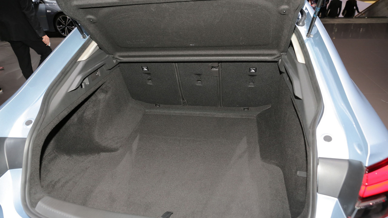

@eljay got some seat time in a Stinger and posted the following dimensions:
I took rough measurements of the trunk for those who were wondering on another thread, which I will never find again, so I'll put them here. 40 inches long; about 36 inches wide at the wheel wells; about maybe 33 inches wide right behind the seat. Sorry for the imprecision, but I couldn't reach that back area easily and didn't put down the rear seat.
That post is here:
https://stingerforum.org/threads/stinger-in-southern-california-showroom.677/#post-5006
I saw that post this morning and immediately started wondering how large the current gap behind the rear seats is in my Optima. I definitely want to make sure my mountain bike can fit inside since I've no interest in messing about with bike racks or installing a hitch. I'll just take those measurements and compare them tomorrow.

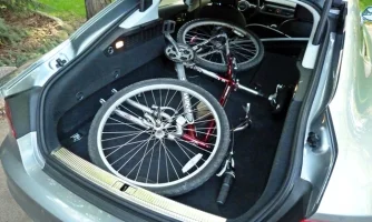

From the Australian review: 406L VDA. Apparently there are different methods of measurement. Pic below with seats down- looks big enough.
It stands to reason that if you wanted to measure the trunk, you'd most likely want to measure it with:
1) Seats up and cargo cover in place (I'm guessing this is the 406L measurement).
2) Seats down and cargo cover in place.
3) Seats down and cargo cover removed.
