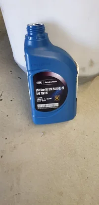

What diff oil did you use for the rear? I have a G70 so visited my Genesis dealer. They were unable to tell me what oil to use and of course had nothing. My next visit is to the Kia dealer but it'd be nice to be informed. So far I believe the correct oil for LSD (Limited Slip Differential) diffs is 02100-00121
Kia 75W-85 LSD oil is part number UM017-CH126, for North America at least.

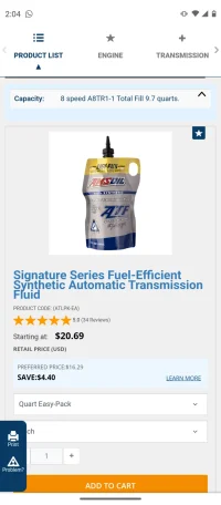

Screenshot_20230105-140418.webpcan this fluid be used instead of the OE one?
