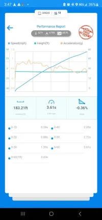

Also with performance, I ran a draggy test. With a leak at the turbo and spinning on my winter tires and overboost I got a 3.6. Im sure with my summers i can get being a lot lighter and grippier. I'm sure I can be in low 3.5s or better. Once my ecu comes back from tork this week.ill test agaun, before without these. My best time with a almost no spin launch i got a 3.75 or mostly 3.9 alot of the times.

Wow, that is quick!
