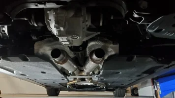

I solved my sound issues with Ultimate Performance downpipes combined to a MBRP Pro catback. After some research, I took a chance and added a pair of Magnaflow resonators to the back of the MBRP x-pipe. Had to cut 18 inches off the connector pipe to the mufflers, but 99% of the tinny, buzzing, farting noises are gone. Only on a very cold start do I get a loud 1 second buzz. The roar is not as intense on WOT anymore and it will be missed, but I'm very satisfied that I can cruise in peace now. Here is a pic of the Magnaflows tucked in after the x-pipe.

Are those resonators welded or clamped to the exhaust.
