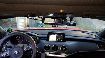

It's silly easy. I actually bought it with the intention of paying to have it installed, but then I saw instructions on how others installed it and gave it a try. I ordered the hardwire kit and that's what made it super easy. Came with everything to just basically plug and play, no splicing or tapping wires. I'll take pictures tomorrow and post them.

I updated my original post with pictures of my camera and install.

Thanks for updating your post, looks nice and clean. Any reason you did that and not just tap in to power at the mirror? I already have a radar detector with the power tapped at the mirror and when I did that I left myself an extra switched power and ground so I could add a camera later.
I wanted to make sure that I had power even with the engine off so the camera can record all the time. I changed my mirror to one with homelink and had to make some modifications at the harness and from that experience it seems like the power gets cut off at the mirror when the engine is off. The circuit I tapped has constant power as far as I can tell, because of that the kit came with a low battery shut off.
Ahh ok, I have a GT2 so already have the powered mirror and my harness has both constant and switched power on it.
Keep in mind running constant power it's wise have some kind of low battery shut off control box and those things are fairly bulky, I don't believe the one that came with my kit would have fit in the panel behind the mirror, so I would have had to route it to another location anyway.
I have the same camera and hardwire kit. The low voltage cutoff doesn't do much. It killed the battery in my old car several times. If you drive every day it's not a problem, but if you leave your car to sit for a while it might not be good.
And getting to the battery when it's dead is kind of a mess, though I think you can jump it from under the hood once you get into the car instead of diving in through the back seats into the trunk.
Good to know. I have left my car sitting for several days before and it started fine, but next time I'll remember to turn the camera off. After this experience I can see the value of a good dash cam so I'll look into upgrading to a BlackVue, I believe they have backup battery kits as well.
I've run my dashcam through the window switch fuse on the Mustang because that slot turns off after 10 minutes or after locking the car from the outside. I never had any voltage issues even after letting the car sit for 2 to 3 weeks at a time when I busted up my Achilles and couldn't drive the car (stick shift).

I installed a blackvue with their separate Power Magic EZ add-on which enables Parking Mode monitoring using your vehicle’s battery. It simply connects to the OBD port. The unit can be "programmed" by minimum battery voltage and max number of hours of live recording after stopping and turning the car off. So it has a timer and voltage cut-off for battery protection.
Cost about US$30 and is a doddle to instal.
