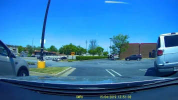

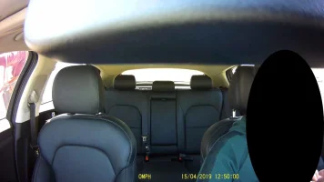

I was parked in a parking lot with my engine off checking some messages before getting out, then I hear a bang on my passenger side. The car next to me banged their door in my car. The driver didn't even bother to take a look and got in her car and was ready to leave. I got out and had to get her attention and I pointed out the door ding. She totally denied it. I told her I was inside the car when it happened. She denied it again. She then closed her door and drove off. I got a picture of her license plate just in case but I knew that wasn't going to be enough proof, thankfully I checked my dashcam footage and got video (and audio) of everything.
Here she is on the left. I have her face in one screenshot as well, and the footage shows her door opening then hitting my car and you hear a loud bang and my car shakes.
This is her driving off in her white cargo van (on the right). I blurred her tag but I have perfectly clear images of it.

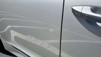

The damage.
It's a small dent but the paint is cracked so paintless dent repair won't work for this.

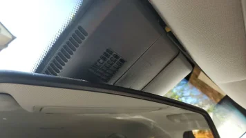

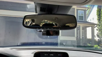

I have mine mounted just under the mirror to get full front and interior view.
Side view of the mount. The mount I have attaches to the mirror stalk. I tucked the wire up the same way the factory wires go. Now that I see if from this angle I guess I could tight up the slack on the cable.

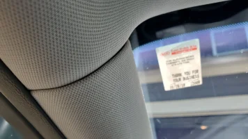

I brought the cable out to this seam on the A pillar and tucked it in the seam. I didn't have to remove the A pillar trim there was enough give to get the wire in there and stay hidden.

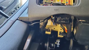

The black rubber weather sealing trim slides off so you can pull up on it and run the wire down to the fuse panel.

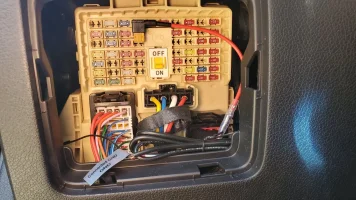

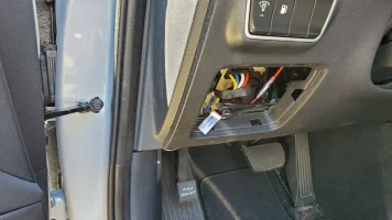

Underneath the cable can go straight into the fuse panel.

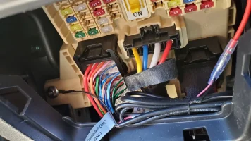

I used the add a fuse to take the place of an existing fuse (red cable). Take the factory fuse out and put it in the open slot on the add-a-fuse and then put the whole thing back in the open slot. No splicing or tapping anywhere. I believe I used the fuse for the interior lighting.
I connected the ground to the closest bolt. I just plopped the extra cable in there. I guess I could zip tie it down.
And that's it. Even for my first time it only took maybe 20 minutes and most of that was unpacking the camera and accessories. I ordered another camera and installed it in my wife's SUV and it took less than 10 minutes.
