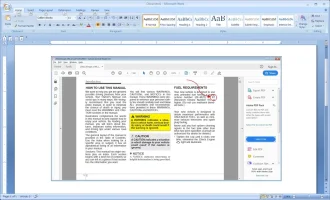

There is a lot of good information in this thread, but it also may contain potentially confusing information to at least USA owners. The OM specifically states 87 octane is the minimum. That's 87 PUMP octane. That is the only number really seen by American gasoline buyers because all gas pumps are required to have the (R+M)/2 method octane printed on the pumps - so that's the number consumers will see. All those posts saying 91 (ROM) octane is the minimum may confuse readers who don't pay close attention to the distinction. Particularly if they don't read the OM carefully as so often happens <sigh>.
